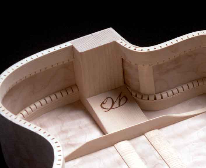

Ok, I'll bite too. Not only do I glue the whole thing down, but I add a foot to help counter the torque that the neck applies to the neck block.
I feel this transfers some of the force to the back and there is less chance of a twisting motion which would result in neck resets.
It's worked so far but I'm only 5 years out. Time will tell.

Hey Paul, what are your thoughts on grain orientation? I notice that with your block you would glueing the top and back to end grain. I turned mine on the side so that I would avoid that. Although, as mine is a cutaway, one of the sides is now glued to end grain.

We also want to see more of that guitar Paul. Three piece back? Quilted maple? Nice linings also.
PostPosted: Fri Jan 27, 2006 11:51 am
Nice idea Paul! May I have it?
PostPosted: Fri Jan 27, 2006 4:38 pm
Please more pics of this build Paul!

Paul, I really like your design...it makes sense. From the little I understand, that part of the guitar is not a big sound producer anyway.

Paul, you went to some of Charles Fox's classes, right? He also uses (or used to use) a version of a "spanish foot" on his laminated heel block to acomplish what you are talking about; was he the inspiration for your design? I think it makes sense, but I also wonder about the grain direction...?

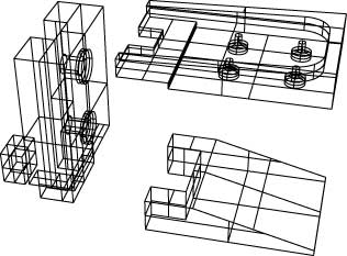

Arnt, yes I studied with C. Fox and worked for him for a short time. It's painfully obvious that he is a major influence in my building. But he does a lot of things that I think are superior.
Here's a drawing of the neckblock that I use. It's 5 peices with the grain oriented in ways that are 1)strongest and 2) there is minimal end grain gluing. So the "feet" have grain running horizontal from neck to tail. The block runs vertical from top to back in the direction of neck to tail. The small block is there as a stop when I cut the tennon but is rotated so that it is longrain against the back of the guitar.

Paul, so this is an "all bolt on system" where you also bolt the fretboard to you neck block assembly, yes? The grain direction I wondered about was the in neck block itself, the part that is glued to the sides. If the sides shrink with humidity, won't the block (with opposite grain direction) push the back and top/fingerboard out? Oh, and in your axionometic veiw it look as though this part is glued up of 4 pieces, but you picture shows a solid block; that's just a CAD thing, right?

It is indeed glued up of four different pieces. That's how I can manipulate the grain to go the direction I want in all the pieces.
